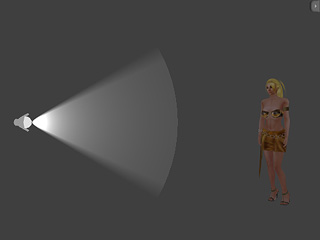

In the Intensity section, you may define the end of the light by adjusting the Range slider. Thus, objects out of the range may not be affected by the spotlight. This may not be true in the real world but it is very useful in the 3D world.
  1. Drag the slider to 470 to extend the distance of the light effect.
  2. Drag the slider to 250 to limit the range of the light.

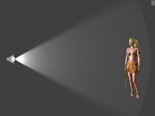

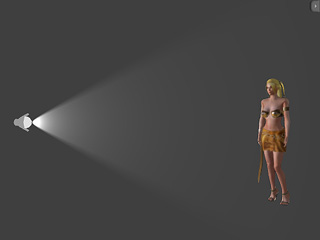

Usually, you will turn on Decay to have the spotlight strength decrease gradually from the light source at the end of the Range. This prevents a sharp ending edge as shown in the illustrations.
Range = 470
Decay = OFF
Range = 470
Decay = ON

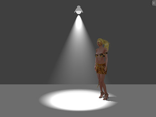

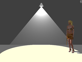

Beam

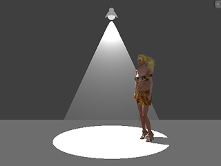

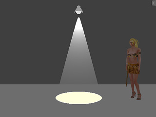

The style of the spotlight Beam can be customized by changing the Angle and Falloff values of the spotlight. The beam generated from the light is in the form of a cone, like you would get from a flashlight. The bottom circle size of the cone is decided by the Angle slider.
  1. Drag the Angle slider to 30.
  2. Drag the Angle slider to 80.
Falloff
If you feel the beam is too sharp, you may blur the edge of the light beam by adjusting the Falloff slider.
Angle = 50
Falloff = 99
Angle = 50
Falloff = 15
