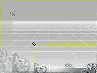

When you have added an image layer to the scene you can move and resize the image layer by following methods:
Ctrl-click to select the image layer and hover the cursor over to the four corners to resize it. You can also hold the Shift key to constrain the ratio while resizing.
Ctrl-click to select the image layer and hover the cursor over it to move it.
Resize |
Move |

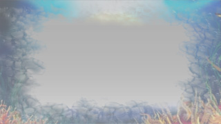

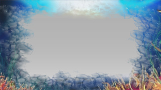

Strength and Opacity are different concepts that may affect different parts of the Image Layer. Strength adjusts the whole image layer's channels effectiveness, whereas Opacity adjusts the whole image layer's visibility.
Strength=0 |
Strength=100 |
Strength=100 |

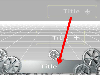

Select an image layer and create two position keys in different frames.
These keys will appear in the transform track under Image Layer.

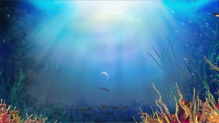

Select the Opacity channel and adjust the Strength slider to 100.
Drag the timeline slider to a new frame.
Adjust the Strength Slider to 0.
Drag the timeline slider to a new frame and set the Strength to 100.
Three new keys are formed under the Material Track in Timeline.
