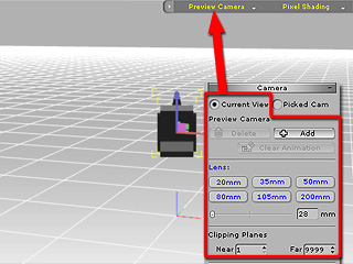

  1. In the Preview Window, pick a desired camera from the Camera Selector.
  2. Click the Add button in the Modify page.
  3. iClone duplicates the status of the camera selected in step 1 to generate a custom camera.
    What you're viewing through the Preview Window now is exactly what the custom camera would see.

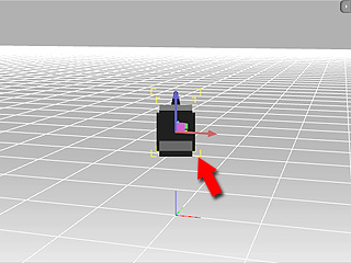

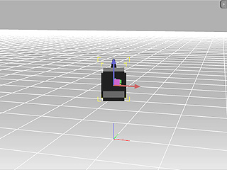

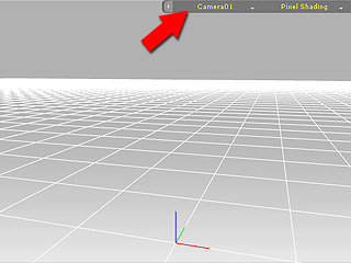

  1. In the Preview Window, use the Camera Selector to pick any camera other than the custom one you just created.
  2. Zoom out the preview window and you may see the Gizmo of the custom camera.

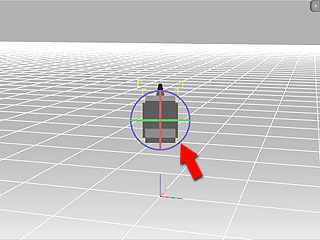

  1. After you see the custom camera in the Preview Window, select it.

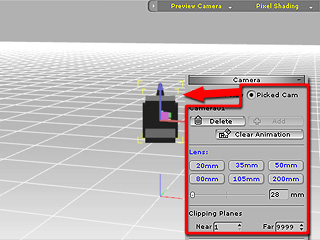

  2. By default, the Modify page shows all the parameters of the current camera with the Current Camera option selected.
  3. Select the Selected Cam radio button and the Modify page will display the parameters of the selected custom camera.
  4. You may then modify the custom camera.
