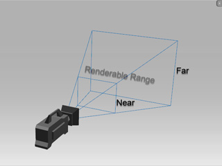

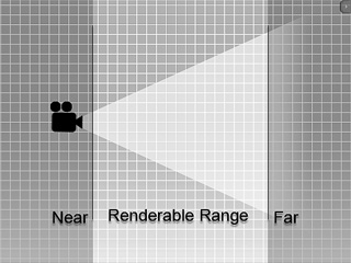

The Clipping-Planes provide two parameters, Near and Far, to define the render range of a camera.

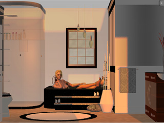

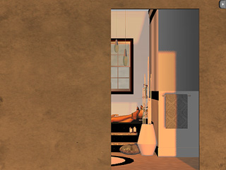

If your actor is indoor, the wall of the room will always hinder the view. You may use the Clipping Planes - Near to filter out the objects within this distance.
  1. Go to Stage/Camera/Modify page.
  2. In the Camera section, click the up arrow of the Near.
  3. Near = 0
    Near = 40

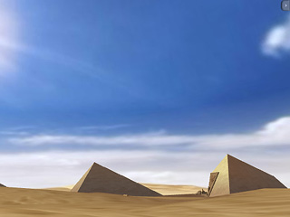

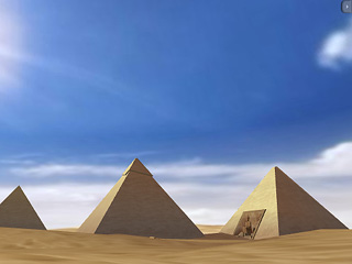

If your Terrain is so wide that it is beyond the camera's rendering range, you may adjust this value to solve this issue.
  1. Go to Scene/Camera/Modify page.
  2. In the Camera section, click the up arrow of the Far.
  3. Far = 9999
    Far = 12000
