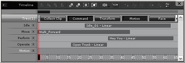

  1. Add clips into each track mentioned above.

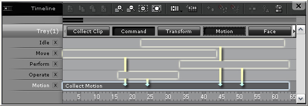

  2. In the tool bar of the Timeline Panel, click the Collect Motion button.
  3. The clips from the named tracks will be merged as single one and put into the Motion track.

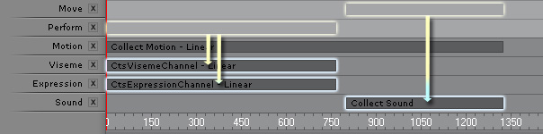

With the Collect Motion feature, you may also extract the sound embedded in the clips generated by AML, such as the sound from the Perform or Move clips.

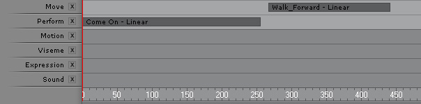

  1. Have the actor perform (with voice) and move with commands. You may see the Perform and Move tracks are filled up with new clips.
  2. Click the Collect Motion button.
  3. The sound from the perform clips will be extracted to Viseme and Expression tracks, while the sound from the move clips will be extracted to the Sound track.
