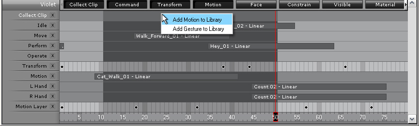

  2. Press the Collect Clip button to show the track, click and drag to include a range in which the desired motion clips or keys exist.
  3. Right-click within the range of the Collect Clip track and select Add Motion to Library. Name the clip.
  4. Browse to a location where you want to save the motion to and click Save button.
All the clips and keys in the tracks listed above will be merged and compacted into a motion file. You may then import it back by right-clicking on the Motion track and selecting the Import command.

If you want to generate custom motions for both hands, you may select the Add Gesture to Library item when you right click on the Collect Clip track. The motions collected will be saved in the Custom library.

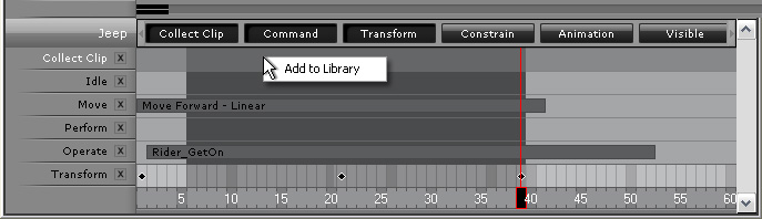

  2. Press the Collect Clip button to show the track, click and drag to include a range in which the desired animation clips or keys exist.
  1. Right-click within the range of the Collect Clip track and select Add to Library. Name the clip and click OK.
  2. The animation clip will be embedded to the prop and added to the Perform list.
All the clips and keys in the tracks listed above will be merged and compacted into an animation file. You may then import it back by right-clicking on the Perform track and selecting the Import command.
