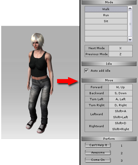

  1. When we have the character selected in Director Mode, you may see all the available commands for the character.

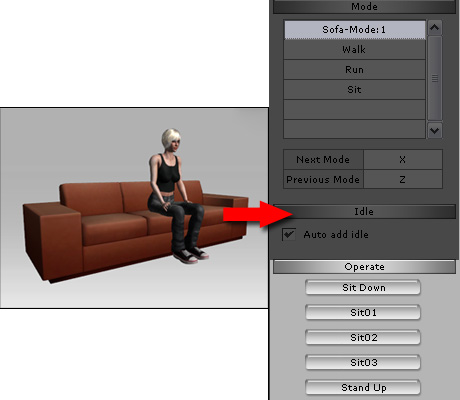

  2. Additional commands appear when you have attached the character to iProps or when iProps have been attached to the character.

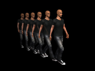

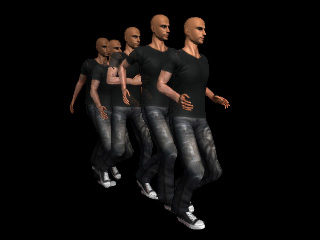

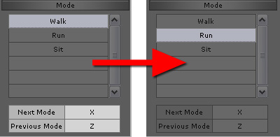

Some of you may have noticed the modes on top of the director mode panel. You may simply switch the modes from walking to running.
  1. The character is currently in the first mode, walk.
  2. Press X or Z to switch the modes from walking to running.
  3. The motion has now switched to the second mode, run.

  • Since we have applied the character onto a target prop with initial pose, please have the character perform the end action to end its performance for the selected command. E.g. If you have a character in a sitting pose you must have him stand up to end its sitting pose.
