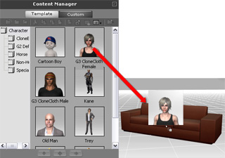

  1. Apply an iProp into the scene.
  2. Drag a character onto the iProp, release your mouse when you see a plus sign on the screen.
  3. The character now sits on the iProp.

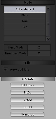

  4. Right-click on the character, the character now inherits all the actions embedded within the iProp.
  5. Switch to Director Mode.
  6. An additional Operate section has added in the modify panel.
    Once you command the character to Stand Up you unlink this inheritability.

  • Due to the restriction on Non-Standard Characters, the Cartoon Boy cannot sit properly on neither the sofa nor bed.
