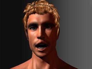

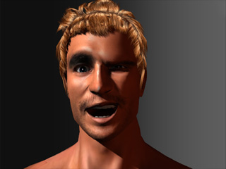

  1. Fine-tuning the expression using this method will creat a new key in the Facial Layer track.
  2. Here is a typical result of fine-tuning a facial feature.
Before
After
Create any facial expressions from the Puppeteering technique. Then fine-tune them with the Muscle or Detail function in the Face Key panel if necessary.
