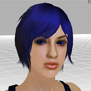

Original Appearance
Diffuse Color:
(Adjust the skin color)

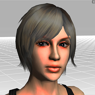

Specular Color:
(Create the suntan effect)
  • You have to increase the value of the Specular to see the color effect.

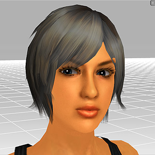

Diffuse color:
Self-illumination: 15
Diffuse color:
Self-illumination: 100
  • It is very easy to create a cartoon look by using the Self-illumination feature.
  • The Light color is white in this example.
  • The Diffuse color is totally ignored as the value is 100.

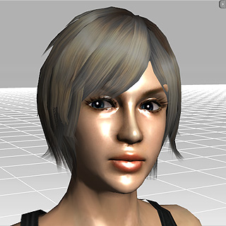

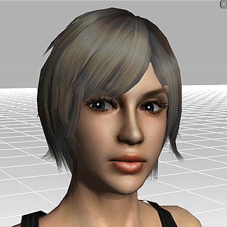

Create Oily or Wet Look Face
If you plan on creating an actor with oily or wet looking face, you need to adjust two parameters: Specular and Glossiness.
Specular reflection is the mirror-like reflection of light from the head, in which light from a single incoming direction is reflected into a single outgoing direction.
Glossiness is based on the interaction of light with physical characteristics of a surface. Materials with smooth surfaces appear glossy, while very rough surfaces appear mat.
Specular: 10
Glossiness: 10
Specular: 100
Glossiness: 30
