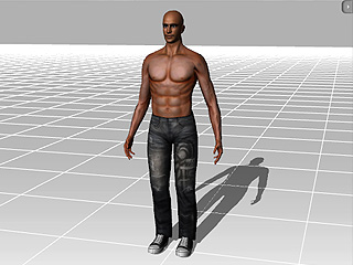

Default Character

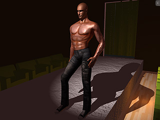

Slim Model

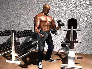

Strong Man
