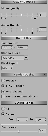

The export iWidget area is split into 4 sections: Quality Settings, Output Size, Render Quality, and Output Range.
Quality Settings
Use the scroll bar to define the quality for exporting the Video and Audio.
Output size
You can define the size of the exported image in the Output Size field. To define output size:
Select either a Standard Size or define a Custom Size using the spinner arrows.
Render quality
The render quality can be set to Preview or Final Render using the radio buttons. Check the Anti-Aliased checkbox to export an anti-aliased image. An anti-aliased output will produce an image with less jagged edges and pixilated areas. You may also check the Render Hidden Objects in case some objects are hidden during the editing process.
Output range
You can either export the entire video, or just a range of frames. Select the output range using the radio buttons in the Output Range field. You can also select the Frame Rate here using the slider bar. The output range can also be set using the 2 triangle markers below the play bar.
Click the iWidget File button to export the iWidget file.
You may alternatively click Launch iWidget button to export .iWidget file and open it instantly in WidgetMe.
