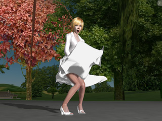

iClone provides you flexible props, Flex Props, to simulate soft objects such as the skirts, ponytails or curtains. This type of prop sways and vibrates along with the wind or any moving objects if it is attached to them.
After you apply a Flex prop, you may adjust settings to change the behavior of it:

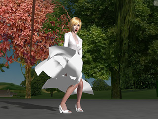

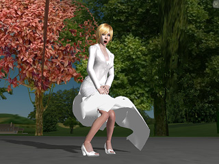

    The Stiffness defines the resistance of the Flex Props to deflection or deformation by an applied force. The higher the value, the more stiff the prop is and vice versa.
    Stiffness = 100
    Stiffness = 2000

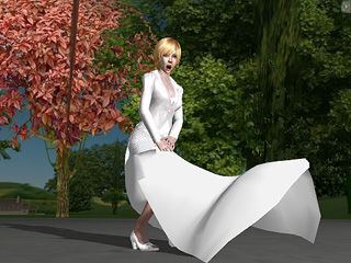

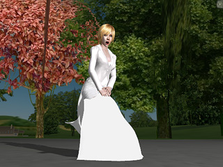

    The Gravity is the agency that gives objects weight. In iClone, this value may be manually set to go along the three axis. This value causes the Flex prop to accelerative move along the specific direction.
    Gravity Z = -200
    Gravity Z = 200

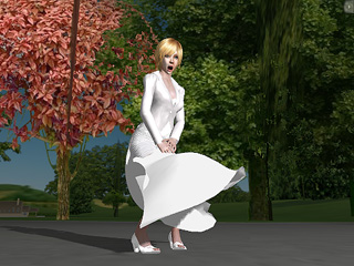

    The Wind, however, influences the Flex prop to move along the specific direction in fixed speed.
    Wind X = -200
    Wind X = 200

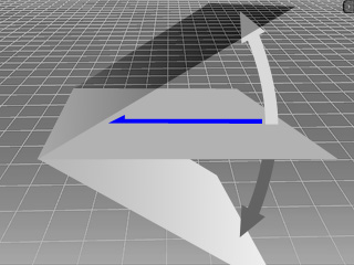

    The Centripetal Force is the external force required to make a body follow a curved path. Hence centripetal force is a kinematics force requirement, not a particular kind of force. For a Flex prop, Centripetal Force is the force toward the fixed ends.
    The blue arrow represents the direction of the
    Centripetal Force when the surface rotates.
