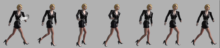

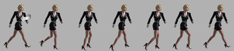

Suppose we have a motion clip loaded into the Perform track in which the data tells the actor to walk with a natural swaying of the body.

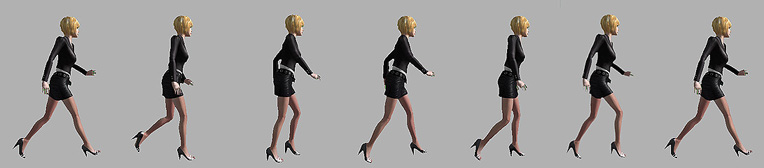

The Pure Key-Frame Motion means to generate motion only by keys in different frames. There is no other motion clips in another tracks.

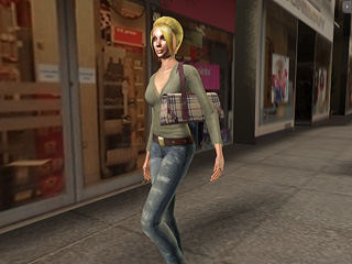

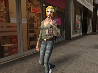

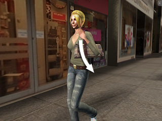

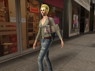

Given a lady walking on the street (Walking motion applied already in the Perform track), we want her to hold her bag with her left hand from frame 0 to 100 and to reach down and swing the hand naturally from the 201st frame, we need to do it as described in the following illustration.

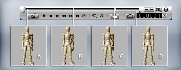

A. Set this key Absolute so the lady's hand holds the bag without being influenced by the motion clip from another track. |
B. Since we don't want the lady to reach down her hand abruptly, we need to generate a transition effect from frame 100. |
C. Set both the keys in frame 100 and 200 Absolute will then generate a transition effect of stretching hand. The key in frame 200 is relatively crucial hereupon. |
D. Set the key in frame 201 Relative so her hand starts to swing along with the motion clip in another track. |
