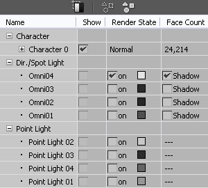

Scene Manager
The Scene Manager displays all the objects and actors included in the current project. You may select multiple items, show/hide the objects altogether, or even adjust the render state of them. It also shows the face count of each object for your reference.
Rename Items: Click on the desired object once to select it, click on its name again shortly after to enter the name-editing mode. You may rename all the items as you wish.
Select Items: Click on the items in the Scene Manager to select them. You may press and hold your Ctrl key and click on other items to make multiple choices.
Select Invert: Click this button to invert your current selection (unselects your current selection and selects all others instead).
Hide Unselected: Click this button to uncheck all the boxes in the Show column of unselected objects so these will be hidden in the 3D viewer. This also saves you from un-checking the boxes individually.
Unhide All: Click this button to display all objects in the 3D viewer, and check all the Show boxes of the objects in the current project.

  • Some items such as water, trees, grass, particle emitters, terrains can not be selected or are difficult to be selected from within the 3D viewer. Use the Scene Manager panel instead to select them easily.
  • The Scene Manger will also show the parent/child node structure of a 3D object so you can use this behavior to select the child node directly.
  • The Show/Hide status of each item will be saved to iClone project files.
