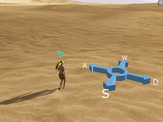

Use WASD hotkeys to move the selected object with motions/animations. (If it is not recording, press Space Bar to start recording) You may also press X key to switch to another set of motion/animation for these four hotkeys.

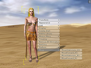

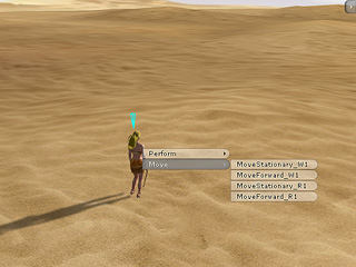

Alternatively, you may right-click on the 3D viewer to pop up the Right-click Menu. Select any sub-command in the Move entry and click on the destination spot on the 3D viewer.

In the Editor Mode, right click on the actor/iProp for moving.
Select any sub-command in the Move entry and click on the destination spot on the 3D viewer .
The motion/animation clip will be stored onto the Move track instantly as the object arrives at the destination.
