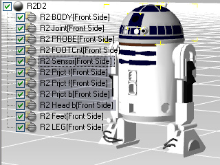

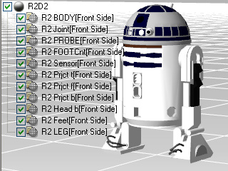

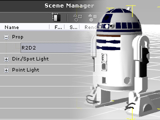

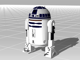

Load a model with multiple mesh nodes. Export (Ctrl + E) it directly without any modification as an iClone prop.
Export unmodified prop |
One-piece prop without sub node in iClone |

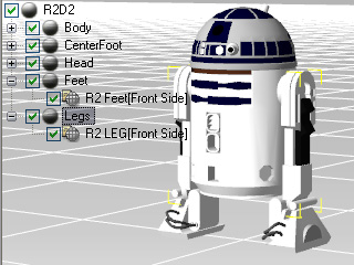

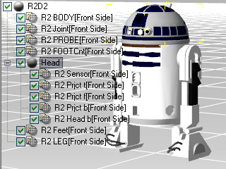

Select one or more nodes that you wish to show in the iClone Scene Manager .
Please note that the nodes you selected must be under a same parent and in the same level in the node hierarchy.
Click the Make Sub-Prop button in the Node Section.
Optionally, rename the newly generated parent node.
Repeat step 2 to step 4 until all the mesh nodes, that can be transformed in iClone, are put into sub nodes. (Please note that you may need to modify the location of the pivot for each root node.)
Root and Sub-Prop nodes generated |
Manipulate the root or Sub-Prop nodes |

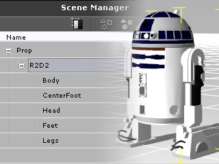

Export (Ctrl + E) the whole model as an iClone prop.
Load the prop in iClone and you may adjust the transform data of the parent node.

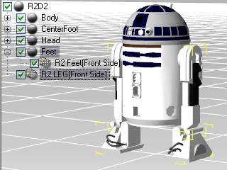

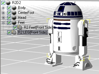

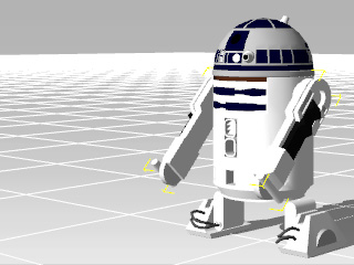

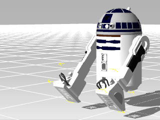

The nodes are now all at the same level in the structure. Transforming related nodes (feet and legs in the example) can be difficult as you must adjust them one by one to get the correct result.

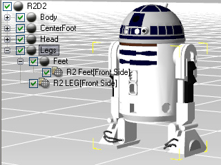

Legs node transformed |
Feet must be rotated and relocated |

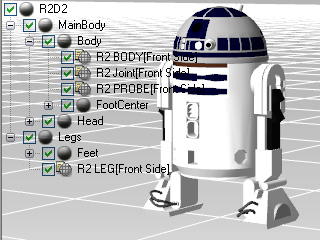

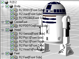

Repeat the Add Sub-Prop method to re-arrange the structure.
Select nodes for combining into one sub prop |
Re-arranged |
The entire structure is re-arranged |

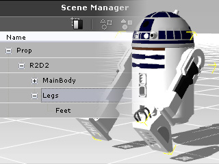

Easier transforming in iClone |
