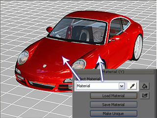

Use the Pick tool to click on meshes and find out if they are using the same material ID (identical name in the Select Material list)

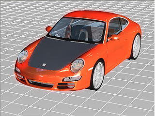

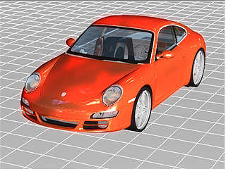

Modify the texture or material settings of the material ID.
The other meshes are all affected
Glow map applied
