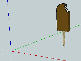

  • Create Model in SketchUp.
  • The pivot of the model is set at the origin.

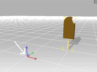

  • Double-click to load the model.
  • The pivot aligns to the world axis.
