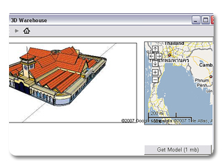

  1. Click the Google 3D Warehouse button on the tool bar.
  2. Search for the desired Model. Click Get Model button. You are prompted to save the model into your desired directory.

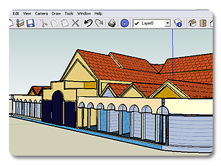

  1. Click File/Edit Original SKP File (Ctrl + K) to invoke SketchUp if you want to re-edit the model.
  2. Click Save in SketchUp after you finish editing.
Model Edited in SketchUp

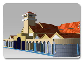

  1. Click Reload (F5) button to reload the edited model into 3DXchange.
Result in 3DXchange
