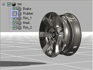

In the Scene Tree, enable the box beside the name of the mesh to include it. To exclude it, just disable the box.
Included |
Excluded |

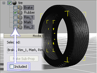

Select one or more nodes and enable/disable the Included box from the Node section in order to include or exclude these nodes altogether.
Included |
Excluded |

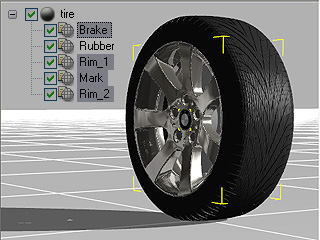

Combine with the Select method, you may use the Include feature to show/hide the node for review before exporting.

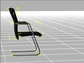

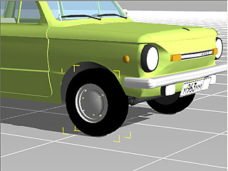

Press the Q key to toggle the Select Object mode.
Select nodes for export.
Click the Invert button.
Disable the Included box so you may show only the wanted mesh nodes.

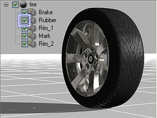

Import a 3D model file. All the nodes in the scene tree are included by default.
In the scene tree, disable the boxes (exclude), on the left side of the nodes, that you DO NOT wish to export.
(You will then see the excluded nodes disappear from the 3D viewer, as these nodes will be excluded from exporting)

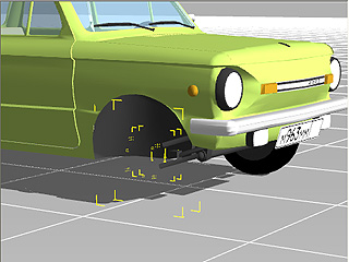

Apply the prop from the prop custom library of iClone.
Result in iClone

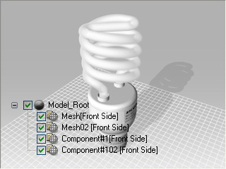

You may use the Included feature to show/hide the specific nodes in order to quickly review the selected results.
Select nodes |
Exclude the nodes to review the selected results. |

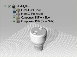

If you disable the including box of the root node or sub-prop node, then the child nodes will be excluded as well.
Root node (Sub-Prop node) included |
Root node (Sub-Prop node) excluded |
