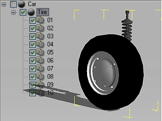

If you want to export only the selected mesh nodes, then make sure you have selected one or more mesh nodes and then enabled the Export Selected Model Only box.
(Please note that the standard character, non-standard character and the non-human character are not supported in the Export Selected Model Only feature.)
Export Selected Only: Disabled |
All included nodes will be exported to iClone |
Export Selected Only: Enabled |
Only the select node or nodes will be exported |

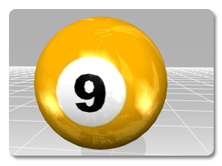

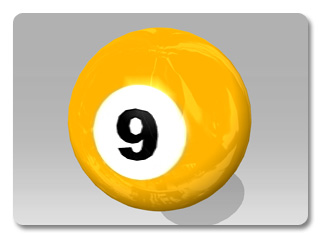

The Max. texture size decides the texture resolution shown in iClone. The higher the resolution the better results you get in iClone.
Original look in 3DXchange |
Export 256 x 256 texture |
Export 1024 x 1024 texture |
Export 4096 x 4096 texture |
