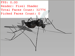

The Total Faces Count will be high since the back faces are all included.
In the Main Menu, select Edit/Exclude SKP Back Faces.
All the back faces will be excluded without affecting the look of the model.
The total face count decreases by half.
