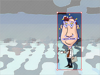

Character Frame
The character frame (quadrilateral wire) defines the Primary Mask of the project. Whenever you replace the background with a solid color or an image, the primary mask retains the color of the original image.

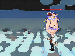

Please ensure that the character frame covering the whole head and body defines only the correct character transformation area, and that the facial animation does not exceed the effective range.
Character Frame
Primary Mask (screen area) Defined
Background Replaced with Image

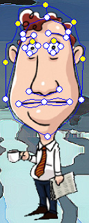

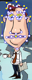

Head Frame
It defines the head area of the model, includes the facial features, the nose, the mouth, or even objects such as hair or long ears that are attached to the head. Please refer to Hair Mesh Layer for more information.
You may click the
Basic Facial Mode
or Detailed Facial Mode
button to view the wire frame
and drag the control points or lines to fit a character’s face much more precisely.
