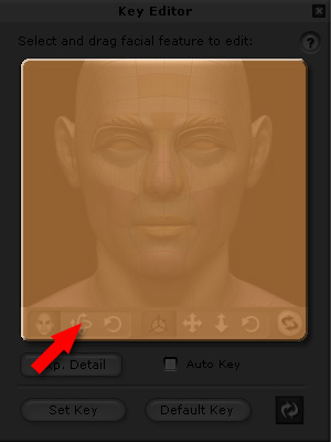

  1. Select the Eyes in the pane.

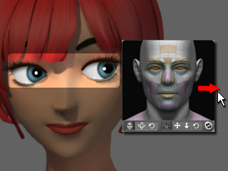

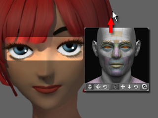

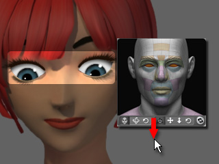

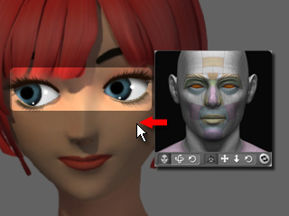

  2. If you are using the mouse as your input device, please press and hold the left mouse button inside the interactive area.
    The Interactive Area
  1. Drag the mouse outside the interactive area to make the changes. The character's eyes starts to move along with your mouse.
  2. Click the Set Key button to save the changes to the eye position.
Note:
  • Check the Auto Key checkbox so you will not need to click the Set Key button repeatedly. The Key Editor will automatically convert the movement of your input device into keys.
