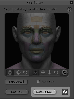

  1. Double-click on the desired key for editing to invoke the Key Editor panel. Please note that the key contains offset data already.
  2. Select any feature in the Key Editor and drag in the interactive area to modify the model's features as many times as you want.
  3. Since it is hard to retrieve the original offset status manually, click the Resume button to abort all modifications.
Setting Default Key
Each time you want to remove all the facial expressions and go back to the neutral expression state or remove the transformation key (rotation, location, scale) and go back to its initial status, perform the following steps:
  3. Click the Default Key button and the offset data will be cleared. The model turns back to its neutral appearance. The original key will be replaced by a neutral one.
