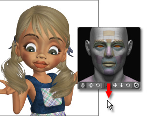

  1. Select the Eyes in the pane.
  1. If you are using the mouse as your triggering device, please press down and hold the left mouse key inside the interactive area.
The Interactive Area

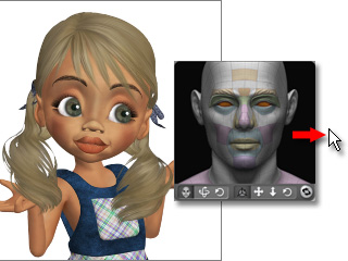

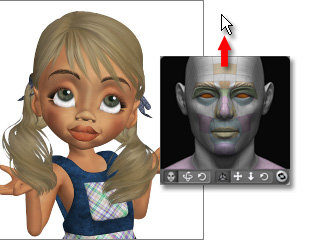

  1. Drag the mouse outside the interactive area to view the changes. The character's eyes starts to move along with your mouse.

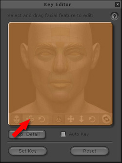

  2. Click Set Key button for the desired eyes position.
Note:
  • Check the Auto Key box so that you don't need to click the Set Key repeatedly. The Key Editor automatically convert the status of features on each mouse-up event.
