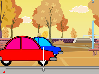

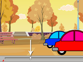

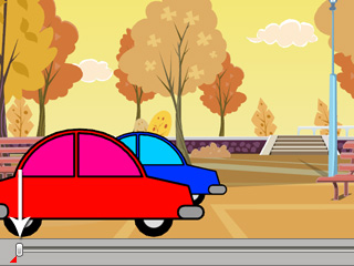

  1. Open the project with animations of different objects. Start from the first frame (two cars moving for example).
    Animations start from the first frame.
    Animations stop at one middle frame.

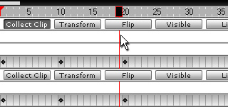

  2. Open the Timeline (F3).
  3. Click the Track List button and select Project to show the project track.
  4. Press down the Collect Clip button. Click the first frame on the track.
  5. Click the Insert Frames button on the tool bar. Enter a frame number before the start frame.
  6. Click the OK button and the specified number of frames will be added before the start frame. The animations will be postponed (The cars start to move later) and the total length of the project will be increased.

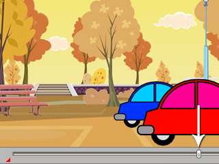

  7. Play the project to view the results.
    The animations will be delayed.
    The animations will stop even later.

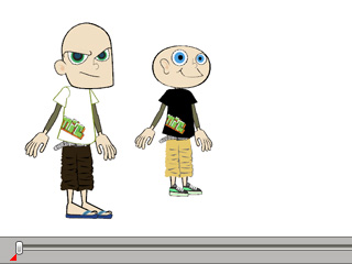

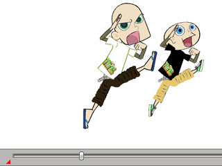

  1. Given a project with two characters performing the same motion by body motion keys.
    Same start poses

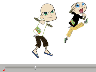

    Motions end at the same time frame

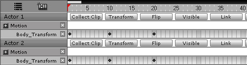

  2. Open the Timeline (F3). Show the Body_Transform tracks of the two characters. Since their motions are identical, the keys positions will be at the same time frame.

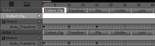

  3. Click the Collect Clip button of one character to show the corresponding track.

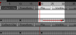

  4. Click on the cell where you need to insert frames.
  5. Click the Insert Frames button on the tool bar. Enter a frame number.
  6. Click the OK button and the desired number of empty frames will be added.
  7. The time of the two keys will be extended, as well as the transition motion in-between.
    Same Start Pose
    The transition duration extends
