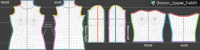

    Template Map
Outer body garment mesh texture template
The Minimum Bleed Area in the UV reference image indicates you where to paste and fully overlap your cloth onto it. This can prevent the result from image-distortion at the side seam of the outfit.
The edges of the same color contour lines will be sewed together in Viewport.

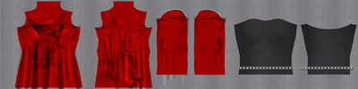

    Diffuse Map
Add texture and graphic design to clothing.
When you are familiar with basic Template Map, you can start making your own clothing.
