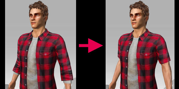

Shorten the pants and sleeves by adjusting the Opacity texture. |
1-2 |
Apply the Sleeve accessory. |

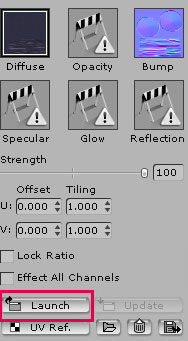

Press Launch to edit the Diffuse of the accessory. |

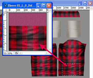

Not only you can load material of Wrinkle and Template map, there is an easy way to make the accessory part of the clothing. Cut a part of the sleeve texture and past it onto the sleeve accessory texture and then save the Jpg
(Not save as new). |
1-4 |

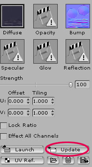

Go back to iClone3 and press Update. The diffuse for the sleeve accessory has been changed. |
1-5 |

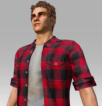

Adjust the position, size, and style to create the thickness and hardness of the rolled up sleeves.
(Edit Bump texture if required) |
