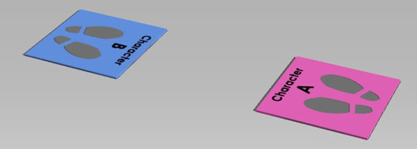

Apply the persona dummy. You can find dummies from Set\Props\Arguments Motion |
The pink dummy is for the character A and the blue one is for the character B. |

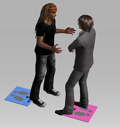

2 |
Drag a character to the pink dummy and then drag the other character to the blue dummy. |
Click the Play button and the characters will play interactive motions. |
Uncheck the Show of dummy to hide the dummies. You can also press 'Ctrl + D' to show or hide them. |
