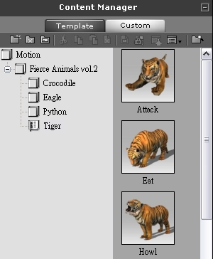

Animation |
1. |
Please uncheck the Align Actor Motion from
Animation before you apply motions to an animal. |
2. |
You could go to Animation section and apply the
motion that you like. |
Although motions for different animals can be applied to all animals, it is not recommended. Strange results may occur when you do that. |
