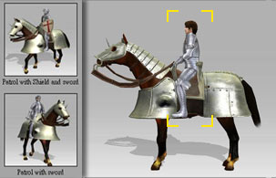

The position of the character on the horse is based on Jack's body.

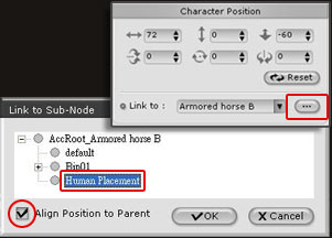

1. Double click on character so he is selected.
2. Choose Link to:
Armored horse B in the character position module
under character tab.
3. You can see the motion after it has been played.
4. After the OK button is pressed, character will stand on the ridding position of the horse because feet are the base point for iClone characters.
5. The character will be positioned correctly on the horse after ridding motion is applied. If you are using different body type other than Jack, you will have to adjust the character's position to match with the saddle.

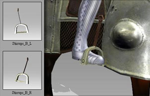

6. Equip the Stirrups Accessories to the character's
feet.
