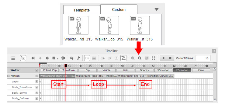

Certain motions have 3 different parts: Start, Loop, and End. This allows you to customize the length and makeup of each individual motion. Follow these tips to learn more! |
1. In this example, we're applying the Start, Loop, and End motion clips for the "Walk Around" motion respectively. |
![](images/Help/Help_Motion_1.jpg) |

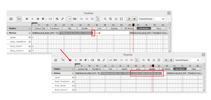

2. Make sure that clip looping is toggled on, then drag the clip's right edge to the right to repeat that clip. |
![](images/Help/Help_Motion_2.jpg) |
3. Check out comparison below to see the difference between a single loop and a triple loop. |
![](images/Help/Help_Motion_3.gif) ![](images/Help/Help_Motion_4.gif) |
